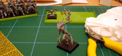

I\'ve finally started my wood elf army, and have decided to use brass etch leaves on my dryads, three different types so that I can distingush between three units.
I\'ve just had a go at putting a some brass etch on the first one I\'ve assembled:

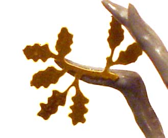

Looks fine from a distance, but up close it looks pap :(
Help!!! How should I be attatching this stuff onto my mini?
Ogrebane
Cover the end bit with glue or even GS. Or cut the straight bit out and just use individual leaves. So where do you get these leaves from then ?
Khaylanis
Make a small cut on the plastic first, superglue, and then use a small amount of GS or BS to cover the area. Should hold pretty well. :)

RuneBrush
I\'ll give it a go with GS on the end then. It also dawned that I should be gluing the metal bit on the top of the branch, rather than the side - doh!!!

Once you\'ve got it attached in a way that suits you, it\'ll help a lot if you play around with the leaves, bending and shaping them and so on, it\'ll really make it look a lot more natural. I found needle nose style tweezers helpful for that.
RuneBrush
Ok, I think that I\'ve managed to get a handle onto how this stuff works now.
