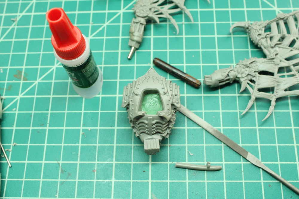

The thorax is hollow so I filled it with a big blob of green stuff. I wanted something solid for my magnets to sit in. If you are following along at home make sure you leave enough room for the joint with the neck piece.
Once the green stuff is cured you can follow the same steps to drill your hole for the other magnet.
