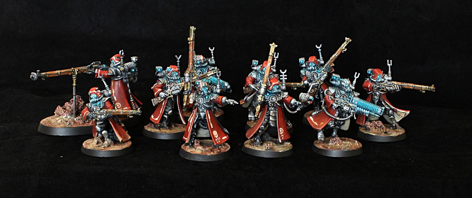

I think the unit looks really good all together and that is what I was I was shooting for. When you paint a unit, as opposed to a single mini, you can focus more on the theme of the unit than on the way each individual looks. Something that might be too subtle for a single model could look great repeated across an entire unit.
In this unit the blue areas don't look that exciting on the single units, but when you put them all together I think it really starts to work.
My plan from the beginning was to copy the Games Workshop box art, but I wanted to make it a little more exciting and I thought that doing some basic, but subtle, OSL would make the unit look really good.
