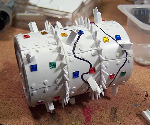

OK, let\'s get this out of your system right away. Pretty eh? Nice shiny Eldar like jewels encrusting that new Deff Rolla? Hahahaha lol lol lol You\'ll be laughing when dem gems are cruching all yourz skulls inta bloody pulps!!! Mash. mash, MASH! :twisted::twisted::twisted:
I myself will have a hard time taking this thing with any seriousness until I primer it.
Now let me explain... I\'ve been wrestling with how to pull off the shallower, pyramid like spikes on the deff roller. (I started to assemble some bikes while I was hatching my ideas) I don\'t have the materials/skills right now to mold my own, although I might look into adding that ability in the future. I though a lot about MonkFish\'s suggestion about the studded belt pyramids and after looking at them, I couldn\'t find ones small enough. I spent lunch yesterday at the local mega-craft store and the closest I found were these.
Pretty, I know, and they don\'t actually come to a complete point, but I think the smallest ones will do. I can always knick up the edges to make them look like they were spiky but have been worn down after a multitude of victims. I\'ll have to primer this soon...lol
I-beam mincers to chew things up more. I\'ll be adding some chain wrapped around the roller as well - I think that\'ll be enough detail to keep da enemy mesmorized enough while I crush\'em good.
