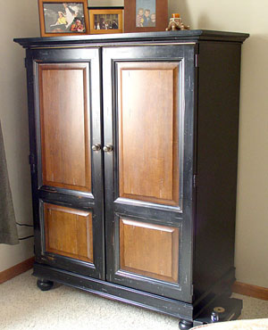

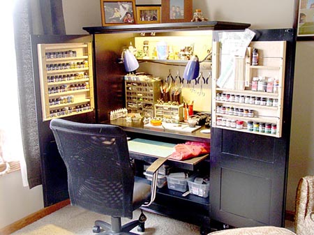

I think Airheads got the right direction for ya. Similar to what I use...
Closed
Open
I\'ve got daylight bulbs in two gooseneck style clamp-on lamps. I use the keyboard tray as my cutting/filing/sanding surface and roll it back to keep the dust from the painting surface above.
I built shallow shelves with wire rails to keep the paints in the doors.

cheers guys, yours seems spot on sukigod, think i will mount the monitor above as its tft and wireless keyboard mouse so they can just pop away. any ideas on material for the work surface? i have a laminate at the moment with newspaper over but thought maybe metal top, and i think someone suggested once glass board for cutting and stuff

I\'ve got one of those green, self healing cutting mats on the keyboard tray (for cutting, of course) and I found a roll of very thin cork with an adhesive back that I put down on the main surface. Softens the blow should I drop a metal piece while painting. It also keeps things from sliding around.
